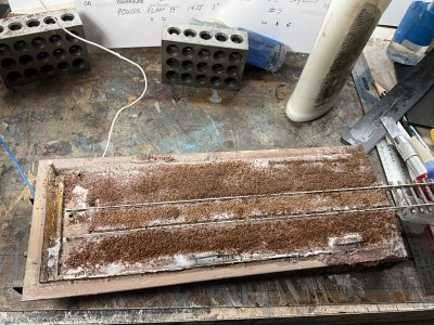

I have been working on the hard packed dirt floor inside the engine shed.
The 1sr layer to cover the floor and ties was just straight from the bottle Golden Molding Paste. I did that
last week and it took a few days to dry. I cleaned the rail head and inside of the rail ASAP, then ran a wheelset over the rails. Then moved it aside
2 pictures above just showing prior to the 1st layer
This morning I created a slurry of the Golden Molding Paste, water, fine earth turf from WS. and some Arizona Rock and Material fine dirt and covered the floor again. I did tape down some Evergreen Scale Models #293 angle to cover the rail head and give the wheel path in the harden dirt.
Applied with a wooden tongue depressed the slurry. I have the timer set for 45 minutes to smooth out the mixture some more and probably with a wet finger.
This is what I’d like to get close to for the floor

I used Golden Molding Paste with a few drops of Model Color #70.872 added and then water to create a slurry to cover the styrene floor and the ties. Done in 2 pours and 72 hours between the pours. I did cover the rail heads and create a groove where the wheel flanges will roll. I used Evergreen Scale Models angle
Today I started adding the 1st layer of the dirt floor. I wasn’t that careful smoothing out the Golden Molding Paste as I knew the packed dirt floor will even the floor, sort of self leveling.
I wet the floor with a spray of 75% tap water mixed with the 70% concentration of Isopropyl Alcohol for the other 25% of the mix. Then I took Elmer’s white Glue All and spread it on the wet surface. Took my custom mix of dirt and with a spoon lightly spread it over the glue. I divided the shed floor into thirds and did each section the same way.
Tomorrow morning I will vacuum the loose dirt. Depending on how it looks will decide if I need more of this base dirt or I can move to the next color

The floor of the engine shed
While the paste portion of the floor looks and is rough, the dirt is sort of self leveling. Here I had added the glue as described above and then added the earth. Did each section individually
