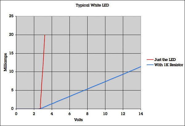

Doug -
Always use a series resistor with each LED. Unlike a regular light bulb, they do not appreciate being driven by a fixed voltage because the current will vary wildly with tiny changes in applied voltage. It is very easy to exceed the maximum current rating, typically about 20 mA.
The red line shows an LED without a resistor. The current (which determines brightness) is too hard to control. With a 1K resistor, the current is easy to adjust.
Common practice would be a 1K ohm 1/4 watt resistor for use with a 12 volt supply. To dim just one LED, increase its series resistor to 3.3K, 10K or even more depending on the look you desire. To dim them all at once, use an adjustable power pack or make one with a 3-terminal regulator such as an LM317.
All the best.
