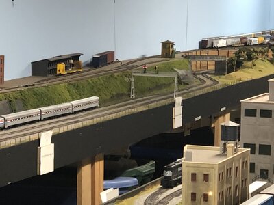

And the final pic until I build the signals and paint the structure.
Placed the signal bridge on the layout just to see the color. ( Didn’t feel like crawling under the layout to get to its permanent spot ) Looks decent but a little too lite. Going to hit it with some Southern Pacific gray with the air brush. Then finish up with a little weathering.

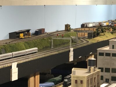

Completed! Very pleased! My only concern is that the 1/2 watt 470 ohm resistors that I used get hot. I’m guessing all my other one do too, I just never noticed.
