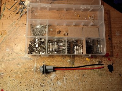

Myself, I prefer breakers for mainlines and light bulbs in yards(cause it is cheaper, less complicated). T15 pigtail sockets are cheap and you can get 912(~1.1A) or 922(~1.8A) bulbs for them at any store. If you go with bulbs, make sure your wiring is ready to handle the bulb's output for a long period without heating.
But be aware that bulbs will never stop delivering power and just because the wiring is ready for that, it does not mean that your loco is!!!!!!
DCC breakers and bulbs are meant to protect your layout's wiring and frog switches, NOT decoders.
DCC is not the only thing in need of protection.
Take a look at lighting, say you have a 2A supply hooked up to a bunch of lights. Technically, you need a fuse to protect the supply and it's buss wires(say 1.75A), and them smaller fuses to protect each module's tiny #32 lighting drops(say .25).
