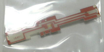

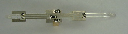

(3)Kato has updated the design of the SD70M chassis. If the circuit board looks like this:
Then it is the old style. If it looks like this:
then it is the new style.
If it is the new style, then according to N Scale Supply, the MRC 1806 should fit.
