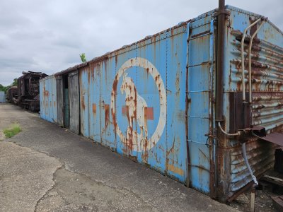

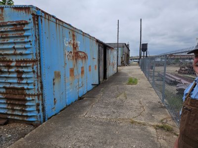

At the North Carolina Transportation Museum in Spencer NC 2 years ago.
