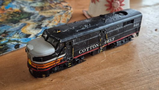

My enthusiasm for rescuing demic wrecks of ebay has seen this distressed example arrive:
It's what's left of a Life-Like Alco FA, the Espee empire (as far as I can tell) never rostered them, only the six axle PA variant. Therefore I am declaring this as a Neverwazza.
It needs parts which I am confident I can either locate or scratch build, it may even stay as a neverwazza Espee unit, all be it after a complete strip down, repair and respray.
Good thing I like a challenge...

Inspection of the FA reveals that it's a runner but the clicking indicates the usual Proto cracked gears, easily dealt with
The bodyshell has been stripped of fittings:
The parts put aside (and sone parts now ordered too):
And the model's heritage has been revealed:
A dip in some IPA is next...
