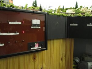

Here's how I mounted my control panels. Shown is a lighting/power panel mounted vertically on the fascia. The panle is a picture frame with Lexan insert and painted on the backside. The frame is hinged so I can open the panel for servicing if needed.

Nice, wel I've started to make the control panel, being an odd shape for the top, getting plexiglass is very expensive, might try IKEA and get a photo frame since they use plasic and cut that down
I found that using anything plastic, like Plexiglass, usually ends ups with the plastic breaking when drilling holes or even during handling once the material is weaken due to the holes. I tried using Plexiglass several times. I recommend using Lexan for the panel face.
Since most control panels are smaller in overall size, check with local Lexan dealers for scrape pieces and they may offer a discount for the material. Practice cutting the material with a scrape piece.
Secure the Lexan to the frame using silicon caulk on the inside of the panel.
Small panels can use Gator Board as the facing material. Reinforcement the backside of the Board after drilling the holes.

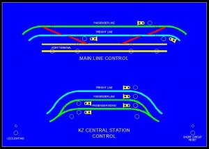

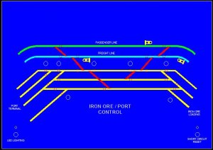

Thanks, I'll have a hunt around for those. In the mean time I've come up with my control panels. I asked my son what colour they should be "Blue" was the response.
Since I have two control panels the LEDS on the Iron Ore/Port Panel are controlled with the Main Line Panel.

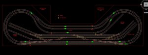

Well it's time to change the layout, after researching car dumpers and ore loaders my orginal layout is not big enough to accommodate both on the same layout. So I have come up with this, however I was hoping to make more interseting from an operations point of view.
So idealy, I would like to make it modular but using 1200x600 insulation foam. I'm looking at trying to reduce the footprint of the car dumper to give me more space.
But at the moment I just can't see it. I have looked at making it a T shaped layout with a background to seperate the two, but it just looked wrong, from above anyway.
Any thoughts would be great.
