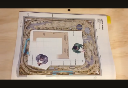

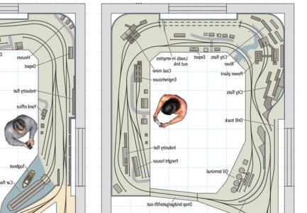

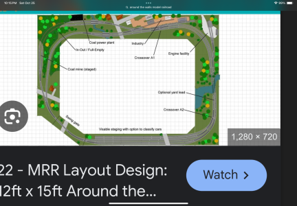

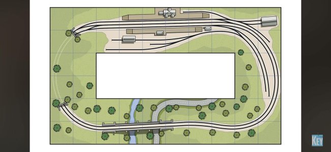

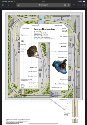

May I suggest looking through track plan books. Like 101 track plans. And seeing the different configurations in similar space
I have been already, so many great ideas, hard to pick. Biggest thing is what will fit. I have also been on custommodelrailroads, and modelrailroad design, Facebook……so many options and I will utilize ideas from all of them.

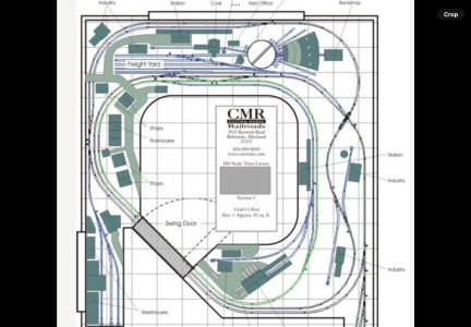

The swing door might be a challenge, but I like the CMR layout the best.
The CMR is my favourite as well but is very difficult in my smaller space. I am trying to use the aspects of it though.

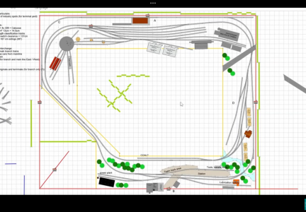

Gary: This HO Scale? You don't show the room the layout is in...so if you can get around it on all sides, good. If not, you could have problems at the bottom right, and both top corners. If those are 1' major squares you are looking at ~36" for reach in.
Why is the building bottom left so far away from the bottom edge? Move it down and gain some room. What are those 3 buildings on the right side? To me, the TT placement is iffy. Move it closer to what looks like a yard and provide entry for it from there. If it is a 'yard' need some sort of escape track for power coming in.

Thank you, and yes it is HO scale and yes roughly 9x11.5’. The building is the end point station and I want to see the front of it. Yes I am losing room for sure. The 3 buildings on the right are walthers downtown buildings etc…..mainly trying to fit as in real life there are real commercial buildings there. If you go onto the Maritime Federation of Model Railroaders and search Gordon Wahay you can see his incredible Halifax layout tour that shows the scene in front of the station. His layout is point to point where mine is not.
