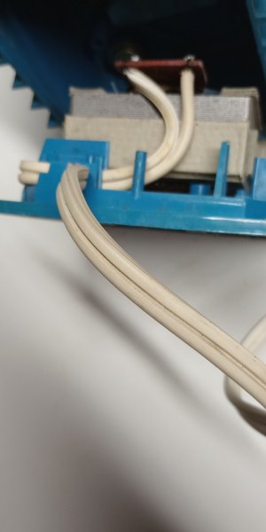

You know the cord is good if it is flexible with no cracks. If it does it will need a new cord.

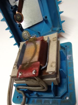

That can be a problem if you cannot access the case. The ideal solution is to get inside and solder a new cord to the coil lugs.
A secondary repair is to leave four inches of the old wire out. Buy some insulated crimp connectors and spice the new cord in and electrical tape or shrink tubing. Remember the cost of these is minimal so replacement can be a safer solution.

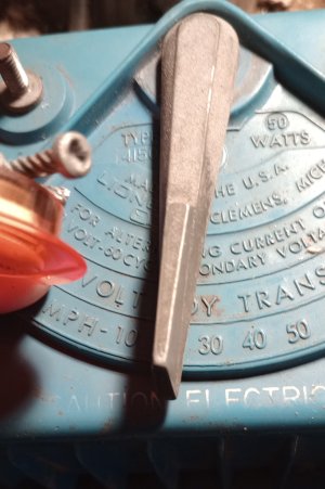

The transformers a 4125 and a 4150 have security screws, It will take an oddball bit to gain access. To describe it as two round sides and two flat sides.
Cool find, nice little transformers!
During the early 60s, UL and internal safety policies pushed Lionel to use tamper‑resistant screws on small transformers. The 4125 and 4150 were marketed for starter sets, so they got the “kid‑proof” hardware.
I think the screw you are describing is a Clutch head. A Type-G Clutch head bit might work.
Now I'm curious, let me know what you find out.
Ok a second look confirms your info. They do have that figure 8 design, but it was hard to see. The screws are small and not the best quality.

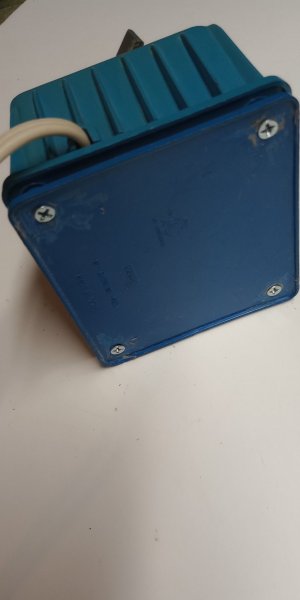

My clutch bits are way too large. I used a square S 0 bit with rounded edges and that was enough to get two out,
Time to shop.
Here is the removed screw from the transformer 4150. The last two screws were drilled with a 3/16th drill. The heads removed and then opened. Once opened a vice grip grabbed the remnant for removal.IMG_20260212_153804482copy.jpg
Here is the new cord installed. It is used but not as old as the original.
I used 3/4 inch number 6 wood screws for replacements. The Base was repaired from the drilling, by filling with epoxy. When hardened, I made a pilot hole for centering then drilled a 5/32 hole for the screw. It was countersunk with a 3/16th inch drill bit. The epoxy was leveled off first with a Dremel drum sanding bit. I use a polishing/wax compound to clean up transformer cases. They clean up well and get a little shine too.
