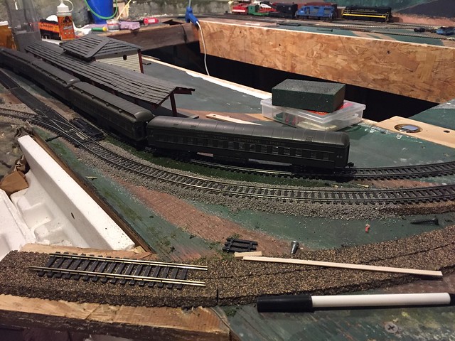

A lot of really good ideas here, most of which I will be employing at some time or another as this scenario will likely present itself again and again. For now, what I've done is ripped up the track and cork about 8 inches back onto the pink foam and shaved down the pink foam the thickness of the cork. This was needed in two places, and it's quite obvious which one I did first. 😣 The benefit is that the transition will happen in a hidden area so the strange shape of the roadbed won't be too noticeable.
I haven't reattached the track yet, but you can see what I did here:
(this is the second side I worked on, not going to embarrass myself by showing the other)
