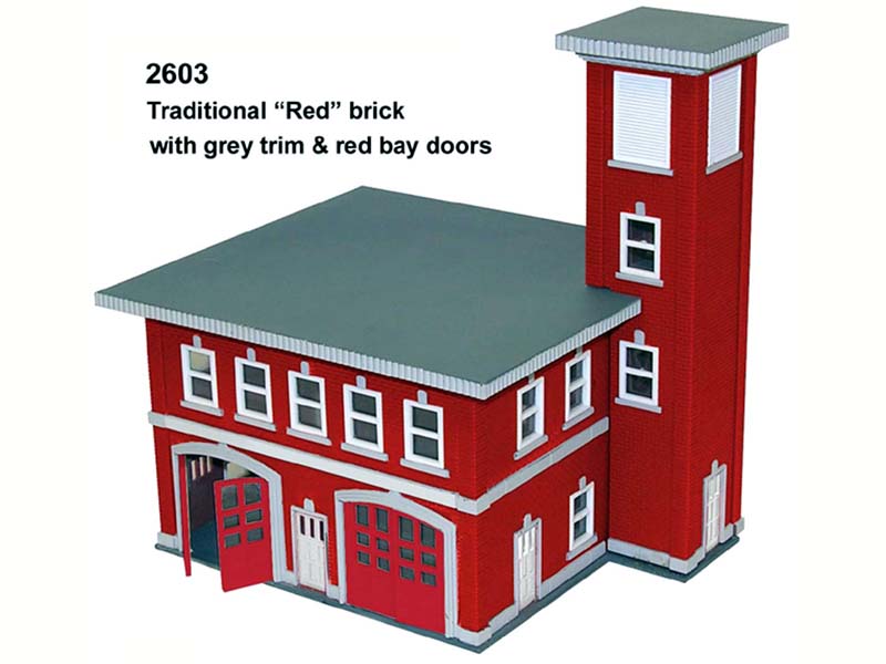

Is this a modern or transition era station? Older stations almost always had wood doors that opened outward. You can make these from styrene with a pin, top and bottom, to fit in a hole drilled in the door frame.

That would work, Ken, but very few modern fire stations have a second floor since the advent of steel buildings. Personally, since you can buy the Pikestuff modern fire station kit for $12 at http://www.modeltrainstuff.com/product_p/541-0019.htm, scratchbuild really seems like it's not worth the effort.
DM, at $106 plus shipping, I think I'd have to pass on that one. :)
Mike, I think new two story stations are more common in areas where either flat land isn't available or it's expensive. With the exception of the fire headquarters building in Montgomery, I can't think of any in this area that are two story. It's not unusual to see older fire stations that are still in use and have been updated so the example at your link would work, assuming you wanted to go through all the effort to make a set of doors go up and down.
