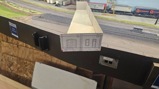

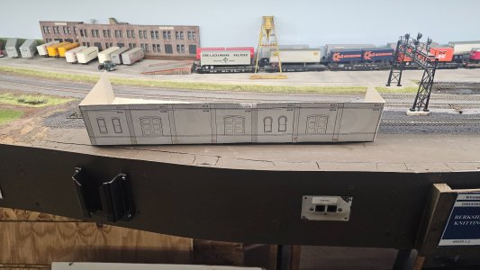

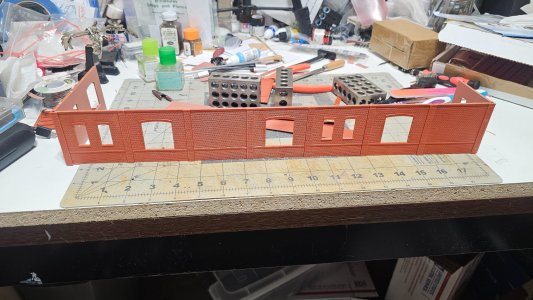

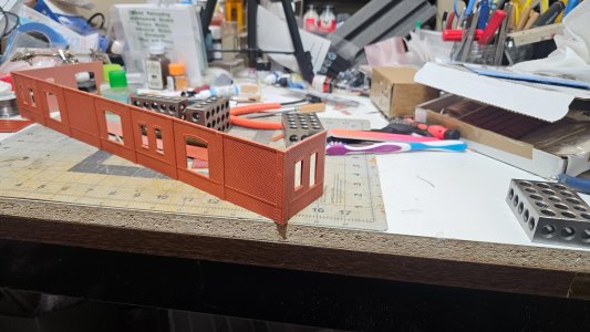

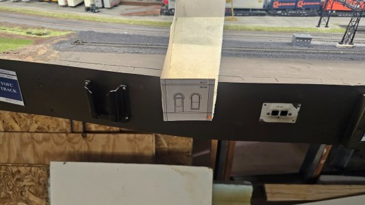

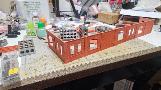

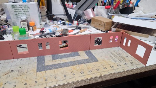

Here's Some pictures of the Proof of concept and of the progress.
Cool project!
I did something similar but only a section of the building.
Oh, you may need to cut the interior brick where the level of the floor will go, at least I had to.
