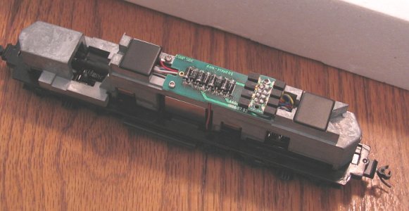

I apologize for the poor quality photos. At any rate, these are the Protos I have. They were in a cabinet at the back of the store, no info on what brought them to the place, and I spent less than $100 for all 12 of them. Never had a bargain like that before. I was so happy, I agreed for my wife to buy a huge chair that still has no one sitting it.

That's quite a deal. Those should all be DC, unless they've been converted by a previous owner. Only thing I'm not sure about is whether they are all "DCC ready" or not. The picture of the circuit board you posted appears to show an 8-pin socket on the right side, with a small board plugged in (the square thing with the 8 plastic wire connection covers around the edge). You may be able to simply remove that board and install an 8-pin DCC decoder in its place, if and when you get to that point in the future. Note: you may need to replace or add resistors for the light bulbs if you convert to DCC. Some small incandescent bulbs will blow if exposed to DCC power.

Re the pics posted in reply 16 above...
Can't help with the PA's or E units, you need to post a pic of the chassis of each.
Not all are the same.
The 4th image (showing the chassis and light board) is more like it. Is that from the GP18 box?
I'll address that one since we can see what's there.
You'll note there's a "DC light board" -- that's the board that's "underneath" and mounted with screws.
At one end of the light board is a connection unique to Proto2000 - the 8-pin "harness" to which all the actual wires are attached.
To convert this to NON-sound dcc, you could use (among others) a decoder by NCE (I think) that replaces the light board underneath (right down to the screws).
Or, you could use a postage-stamp sized decoder, the Soundtraxx MC1H102P8 (also a non-sound decoder).
