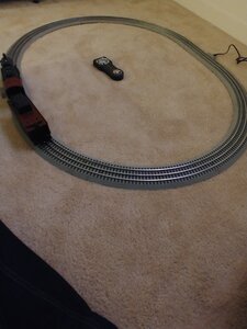

Purchased the ready to run Pennsylvania Flyer kit. It's been running like a champ for several weeks. Added an inner loop to the included circular track layout, train ran fine then accidentally clicked off the remote while the train was in reverse. Not sure what could have happened, but the loco now will not run. Tender sounds all function normally and the light comes on, but no movement, noises (grinding, etc.), remote appears to be functioning fine, bluetooth app is also working but the loco is lifeless, even after cleaning rails and ensuring track has power. Anyone have any ideas what could cause the sudden break?
Thanks GeeTee. I've taken everything down to just the starter track. Eight O36 curves and the two 10'' straights (the one that plugs into the transformer and the accessory track)

I am not at all familiar with Lionel but there's nothing obvious to me in the photo .
My guess is shutting off the controller may have caused a glitch , So the first thing I would try is a factory reset.
