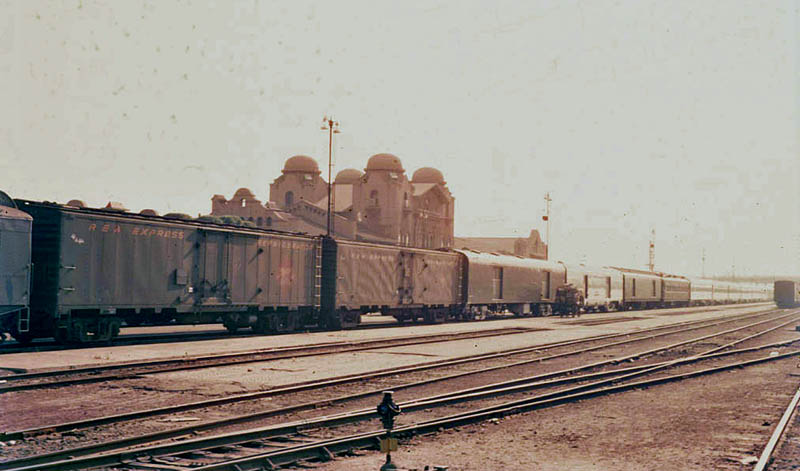

It isn't really classified as a freight car. It is an express reefer so called a "head end car" because it would normally be run at the head end of a passenger train. Notice it does not have standard freight trucks, but rather high speed passenger type trucks.
Here is a photo of some on the Santa Fe Grand Canyon Limited in San Bernadino. In this case strawberries headed east.

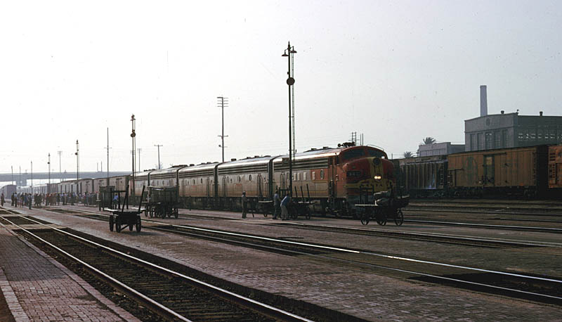

And another with three reefers immediately behind the locos, from a year later
