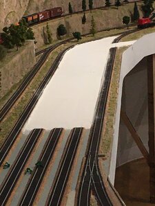

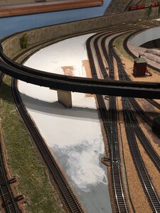

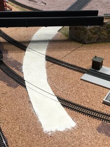

I have made some concrete parking lots and grade crossings from drywall joint compound on my layout and am struggling to get the color correct. I bought some Woodland Scenics Liquid Pigment: Concrete C1217 thinking that would do the trick, but the color is way on the green side. I know concrete is not just one color, and I am not super picky about getting a specific color combination. I just want one that is realistic. What materials and techniques do I need to model these areas?
Thanks for the help.

I've used gray primer from a spray can then painted over it with black, white and burnt umber acrylics I "borrowed" from my kids. Mostly the black and white to get a light gray. Lighter than I thought it would be.
The light isn't as good in the second photo and the concrete is actually lighter than it looks.
Thank you everyone for your help. I have been afraid to get into the mixing paint colors program as I am not much of an artist. But some of your posts and over an hour round trip to the craft store and the fact that I had some paints that when mixed together might work, I decided to give it a try.
I mixed some flat latex gray with some flat latex white to try and lighten up the gray. Then I applied it with a brush to the surface of the dried joint compound that I had scored to represent expansion joints. The paint went on too thick so I used a soft sponge with water in it to thin out the paint on the work surface. It dried a bit lighter than it looked when wet.
I was amazed at how well it turned out. It came out very close in color to some tunnel portals I installed. I may add a black wash later if I want to push my luck to age the look.

Greg, that looks good. I think a thinned, very slightly darker gray applied sort of randomly will break up some of the evenness. Maybe the darker gray on your soft sponge dabbed on will mimic the color variations. The seams collect dirt and are often darker, maybe a thin pin wash or even a pencil in the grooves could bring them out some.
I use our dog for concrete color reference. And notice the dark seams and cracks.
Experience says it's better to not actually paint match on the dog but holding painted samples close to her works fine.
Greg that looks good. Paul’s comments I agree with and once you weather it up it will be great looking. Remember if you don’t like it after weathering you have the formula you used to get it here and can just go over it. You did write down the formula, right? I have no latex paint in the house but the Color you came up with is what I am looking for. Keep posting as you play with it.

Here is the concrete work after outlining the joints with a mechanical pencil and blotching on some darker gray with a sponge. I am very pleased with the result. I will probably add some parking lot lines and some road grime too.
Thanks to all for your help.
