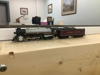

Would anyone have any pointers or tips regarding doing a DCC upgrade on this locomotive? It is a Mehno 4-6-4 Hudson. I got a few screws undone on the bottom and was able to kida loosen the wheels and drive components partially from the body. But got it open enough to the point to see if i kept lifting it out i was going to start pulling apart the guts and wires to headlights.

Thanks i didnt know that. I guess i was kinda mistifyed by all the letters in there description i assumed they had to do with the motor. I eventually got into this Mehano and replaced the headlight with an LED and had a wiring harness left over from the previous installation that i was able to get into the tender. So i now await the arrival of another decoder chip to see if i was successful.

Thanks Louis. I think i got it sussed out as i had a spare wiring harness left over from the other installation that I did and have that wired into it now. I have a chip on order should be here soon.
What resistor did you use for the LED in the Mehano? And what decoder did you find that will fit? I'm trying to resurrect my dad's old 4-6-2 Pacific and may decide to use DCC for it. Originally, was the incandescent headlight bulb just kinda floating behind the nose plate? My unit was undecorated and I just picked up a Microscale decal set for generic Canadian steam loco's of that era.
