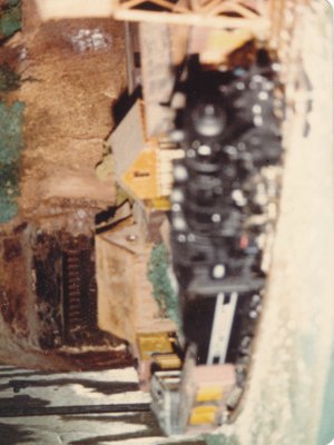

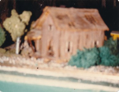

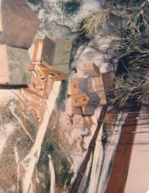

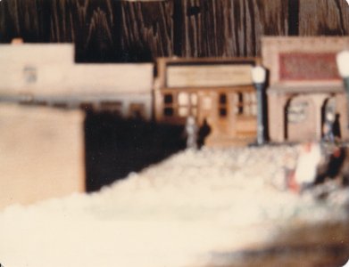

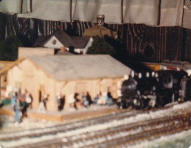

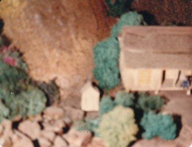

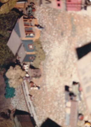

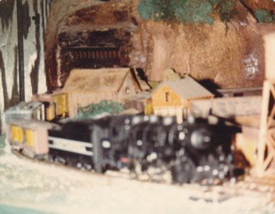

I was going through some old pictures and ran across a few of my first layout and a few under the Christmas tree. The quality isn't real good as I think I was using an old Kodak 110 Instamatic camera back then. I was only in my early 20's at the time. I'm now 69. The locomotive is a Gilbert 0-6-0 ? That my Dad bought when I was about 4 or 5 years old. 99% of the buildings are also the same vintage that my Dad built. I haven't been able to get them out yet to check them ,but it's coming soon.
As a side note ,I finally got the room I'm going to use cleared out ,so I will be ordering the lumber in 2 weeks and the fun will begin.
Can anyone please rotate the pictures that are skewed . When I uploaded them they rotated and I couldn't fix them . Thanks.
