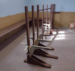

Earlier in the post I had talked about how un-square the walls were in this shop, well the floor is not any better. When they poured it, it looks like they leveled it off by eye and called it good...NOT!
With the point of attachment for the peninsula established on the wall, (and the tape on the floor), I secured the uprights with the bracing, making sure they were vertical front to back as well as side to side. Remember the floor issue? Look at the feet of the uprights. Those are shims between the feet & floor to help fill in the gaps & help add some stability to this whole mess. I marked the shims, cut them off and then reinserted them with a blob of wood glue to hold in place.
In an effort to help minimize expansion/contraction issues, every thing is getting painted. Yes the plywood is painted on both sides. We have a local building supply store here that has pre mixed paint on sale. For $13.00 a gallon, I couldn't pass that up.......
Here is were the peninsula has a dog leg in it to the next section. Because of how unsquare this room/ building is, I was sure to use the same reference point (wall) on what ever I was putting together. Like building the peninsula, I used the same wall to take the measurements from.
Can't be too hard huh? It's not rocket science! 🤣🚀
With the reference point (tape) in place, we'll build out the rest of the peninsula support structure.
To compensate for the dog leg angles, I measured what the angles were in the track plan, and cut them on the two opposing uprights. I then split a 2x4, one for each side, and attached them with some 4" torque head screws. Now I have some place to attach the bracing.
Here is a better view of the off set of the "dog leg"
The peninsula ready for some decking.
I wanted to cut the decking for the end of the peninsula out of one piece of plywood as much as possible, which means I'll need to cut a notch in it for the up rights. I cut the end piece out and laid it on top of the uprights. With some make shift plumb bobs, (3, one is behind the support stick,) I hung the plumb bobs off the spots of the decking that I hade located earlier as reference points. When these three points were lined up with what was on the track plan, I marked & cut the slot for the uprights.
Decking applied, dog leg section has brace across the top.
