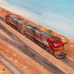

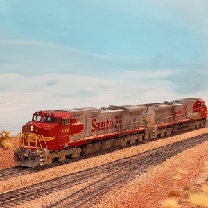

Hello !
Checking the photos I sent a few posts back, I noticed, on photo 1912, that the rear end of the left side handrail was missing !!!
I don't remenber breaking it. Was it broken during the handling process at the factory ? I checked again the plastic bags protecting
the detail parts, nothing.
Anyway I again made the missing part out of metal wire, not perfect but good enough.
Both Katos are now finished, I managed to get alternating flashing ditch lights when blowing the horn on one of them, n° 609.
I attach a couple photos.

I need help concerning the front and rear hand rails of these Katos. I just can't get the posts to sit properly !
It drives me nuts. Whatever I try there are always one or two posts refusing to get in place. I slightly enlarged the holes, I used
tiny drops of CA, nothing works. On the other hand they spring and fly across the room pretty well...
Zooming on photo 1914 will show you the mess on the front handrail.
On my, now dummies, Walthers mainline Dash 8-40BWs, handrails sit perfectly, Kato is supposed to be superior quality.
