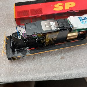

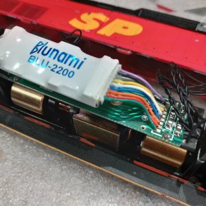

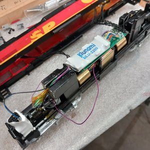

I finally installed a Blunami 2200 in the Athearn SPSF EMD SD45T-2.
After unplugging the original DC board I very carefully cut a little bit of the decoder plastic protection and plugged it to the 9 pin plug.
I also cut a bit of the protection on the other end so I could plug the current keeper.
I again added an ultra flat speaker.
To install I cut and removed part of the rear weight. I installed the current keeper vertically on a small piece of double sided gummed tape and painted it flat black to make it less visible through the grills.
