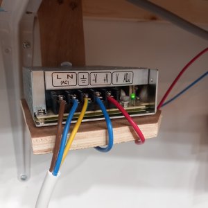

Power supply for each district are MeanWell power units. I chose the 6A model which delivers around 12 VDC. They accept any AC voltage (home power).
They cost about 30 US$ a piece, so far I installed two of them.
6A per district is more than I will ever need.

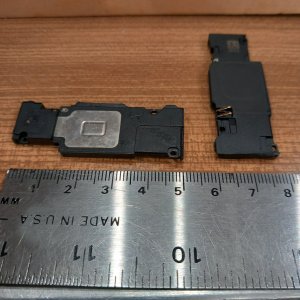

I also found a british company selling ultra flat 8 ohms smartphone speakers. They are 50 x 17 x 3 mm, small but efficient. The company plugs the speaker holes for a better sound. They also have a great choice.

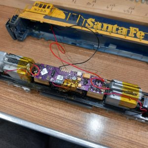

After removing the couplers and the shell, I removed the small tabs holding the wires, 10 of them. Front and rear right pick-ups, front and rear left
pick-ups, motor top and bottom contacts, plus the front and rear bulbs. Then I removed the original board.

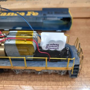

I removed the rear weight and cut it to make room for the current keeper.
Take it easy when installing the decoder, eventhough it fits perfectly, you better be gentle.
I tinned and soldered the existing wires to the decoder, checking their correct tabs as I went. Samething for the new LEDs.

I installed the current keeper on the rear "tower" using double sided tape. There is a small male plug at the end of the 2 wires connected
to the current keeper and a female plug on the decoder, that easy.

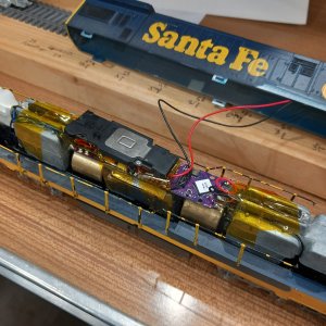

I used Kapton tape to fix everything and to insulate the decoder top before installing the speaker. It's soldered to its own corresponding tabs
and installed on top of the decoder with a small piece of double sided tape.
I installed the speaker with the metal part up for safety, and not on top of the Bluetooth chip... You never know... Well I am no expert.

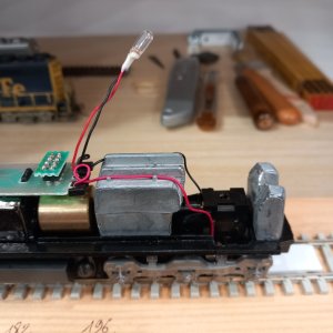

2000 : Weight cut to make room, later on I had also to remove the rear weight portion.
The original board and bulbs are not removed yet.
- Decoder installed.
- Current keeper installed.

- Speaker installed.
- The 6A power supply, I installed two so far.

Nice! What is the DCC control station? I'm not following what the 12VDC power supplies are doing. Are they just applying 12VDC to the rails at all times?
Nice! What is the DCC control station? I'm not, following what the 12VDC power supplies are doing. Are they just applying 12VDC to the rails at . times?
Exactly Kusojiji, that's what those 6A power supplies do, they send about 12VDC in the tracks, that's it.

I also had to slightly cut down (3 mm) the top part of the front weight situated under the cab roof in order to clear the LED diode for the beacon. I use LEDS with diodes factory installed, they need room.
I measured 4,5 mm space between the decoder and the shell, I am happy I found those 3 mm thick ultra flat smartphone speakers. They are 8 ohms and accept the
2A delivered by the decoder.
Their sound is pretty impressive for their size.
