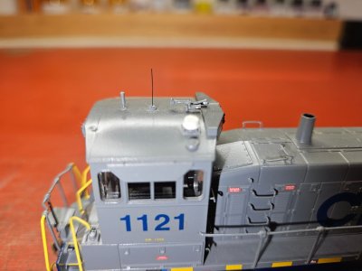

I tried stainless wire once for a radio antenna on top of a car. Same issue. You may end up trying more than one material before you find one that works for you.

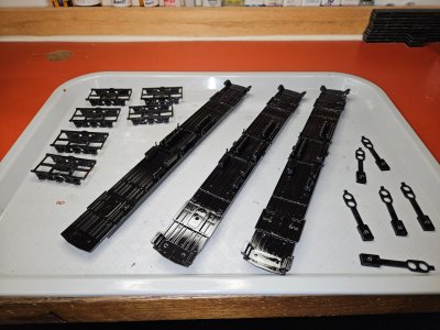

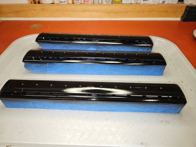

Well I got everything black repainted, came out really glossy, but that's what he wanted.
I have an answer for your radio antenna. Paint brush bristles . they bend and can be bent right back.
That might work for a locomotive antenna, but this antenna is used on passenger cars. It runs most of the roof length and sits on queenposts. See page 5 here, fourth page from the bottom.
