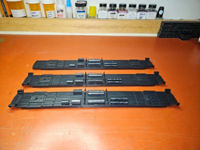

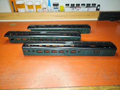

Especially, a question for you on these older passenger cars I'm doing up for a friend.
They give you thread to make the truss rods. Would brass rods be more practical to make them? You can see the supports in the second picture.
Thank you in advance, Jerome
Looks like old MDC Palace car kits. You can try brass rod. It will be more durable but if it gets bent in handling it will want to stay bent, and would likely need replaced to get the proper look again. Thread may sag after time. I would suggest some elastic thread that can be mounted under tension and spring back after careless handling.
Yes they are Palace Cars. I do have some stainless steel rod that is very strong. I never thought about elastic thread. I'll see if I can find some. Thank you for your help.
