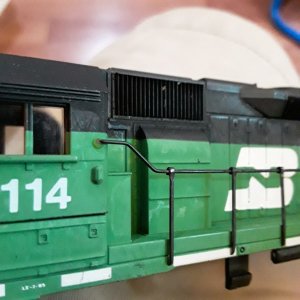

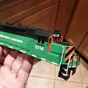

Well finally began detailing this 37 yr old beast, starting with the lowest hanging fruit, repainting the side and rear railings green, and the front/rear climbing rails white (all per prototype). I've ordered numberboard decals from ShellScale, and picked up some lift rings and grab irons from a local shop. Also placed an order with TMR for a firecracker and can style antennas, curved fan end grab, sunshades, MU hoses and cable and low profile weed cutter plow blade. Will also likely add side rearview mirrors, and wipers. That will likely conclude the detailing phase and I'll move into DCC conversion, including front/rear lights and numberboards lights, and a roof beacon, and if possible, sound. Some of the detailing will wait until I do the lighting as those small details will be in the way when handling the cab, and make it more challenging.

step two-Number boards, lift rings/rear fan grab bar done, painted head/tail light bodies per prototype (needs second coat), MU hoses/cable, plow, firecracker/gps antenna and sun shades ready to install, grab irons soon to be installed. Will be pulling the cab off to do the lighting before completing the detailing and touching up the body paint.
