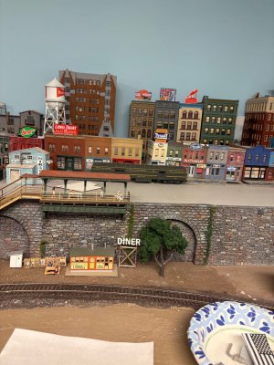

I am cutting all the leads to the track (I'm over 50 percent done) and still read continuity across the rails. I found a turnout under Joanstown that was shorting out and I ripped the frog out. The turnout under Joanstown (see photo) was a big mistake. I laid the track first and built Joanstown around it with just a small access section that I can view the two tracks underneath it. It is made with 2x4x6 blocks (50 of them) supporting a top of Joanstown with all the building on top of that. It is impossible to replace the turnout now.
Take everything I'm saying with a grain of salt, I am very upset with myself for not finding the short. I have destroyed track that I can not get to and the only thing left is to take a Dremel and cut gaps in track sections to help eliminate faulty turnouts. But, I still stand by really considering if you want to go into DCC.

Great looking city by the way!
