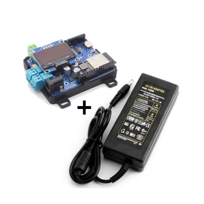

If you decide to go dcc, check out this system:
Two videos to watch:
I am currently running this exact setup. It can run both DC and DCC. Works great for me. I am slowly converting my fleet to DCC
