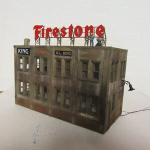

I’m aiming for one of my factory buildings to look like this:
India Ink would work to some degree, but powers or Pan Pastels would work better in my opinion.
Here a building that I used Pan Pastels to weather....

I use India Ink and really liquid sorts of washes when I want to highlight or "darklight" the cracks. If your after coloring the surface I would say liquids aren't the best. The picture you show looks like you want more of a surface type weathering.
When doing brick walls I use a product called Robert's Brick Mortar to fill in the mortar joints of the bricks. I remove as much of the Roberts off the brick faces as possible with a dry wiping rag.
Once completely dried, I then use the India Ink mix to weather bricks if I don't use the Pan Pastels.
Greg
Good point! I am after more of a surface type weathering but I really want the brickwork to stand out as well. Maybe powders are the better way to go?
