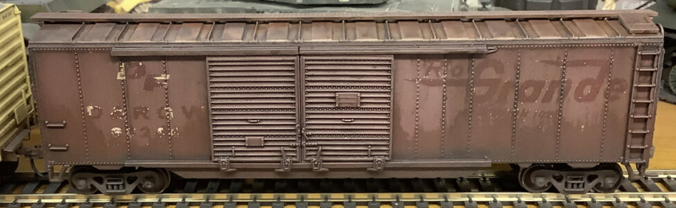

It varies with how much the paint is thinned…
I am using Tamiya… I like it thinned a lot… so I can build up light coats of fade or grime that look natural to my eye
15 psi…sometimes less as the regulator pressure drops…

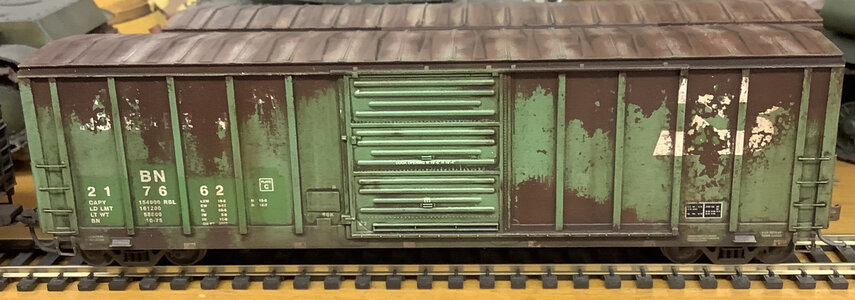

I think when the paint comes out “right” I am at the right pressure for airbrushing…
I always blow some paint out on scrap before I start on the model..
Low pressure I can get closer to the subject..
I just started weathering cars last spring and it’s a matter of trial and error, figuring out what works and what doesn’t, what you can do and what you need practice at…
I’m still working at it
