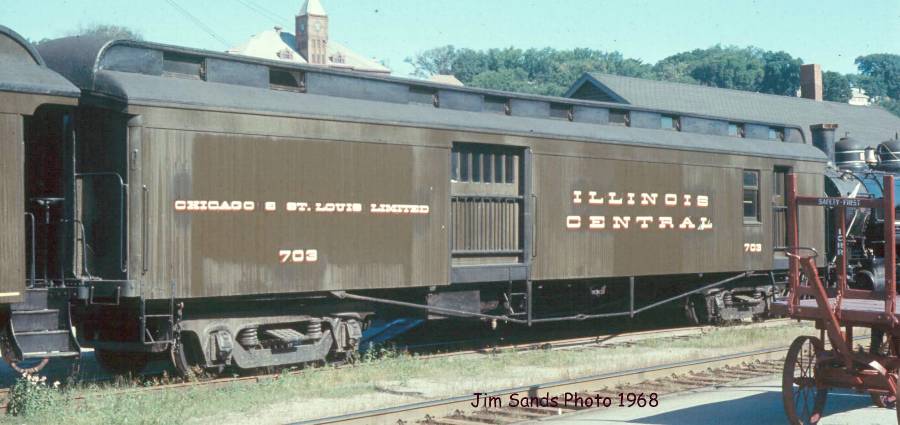

I suspect this Baggage/RPO would be a close match.

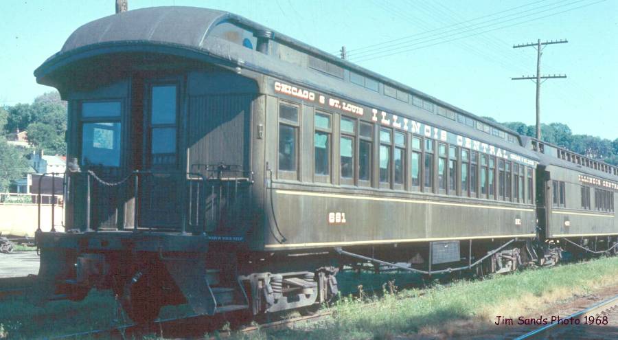

This is a typical truss rod open platform coach
There would have been no rounded roof Harriman cars on the train since they were first introduced in 1906. It looks like Athearn is going to be reissuing the old Roundhouse 85' Pullman Palace cars although they seem to be behind schedule (again). Looks like you can order them at http://www.modelrailcraft.com/PhotoGallery.asp?ProductCode=480-85364 and hope for the best.
Thats what I figured on the round roof harriman cars, they came along later. The bottom pic reminds me of the Roundhouse 50' overland cars. Those would just need painted pullman green and decaled. Thanks for the pics. Mike
