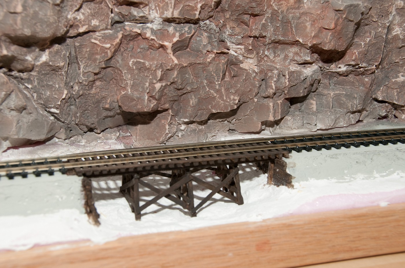

i skipped the water. didn't have isopropil at that moment and used denaturated alcohol instead. again, no mister so i airbrushed it on - mixed one airbrush paint jar of denaturat with just a drop (if that) of india ink. i did want deeper effect though.
EDIT:
didn't take picture immidiatley after but here is the result after i topped it off with reddish acryllic wash.
