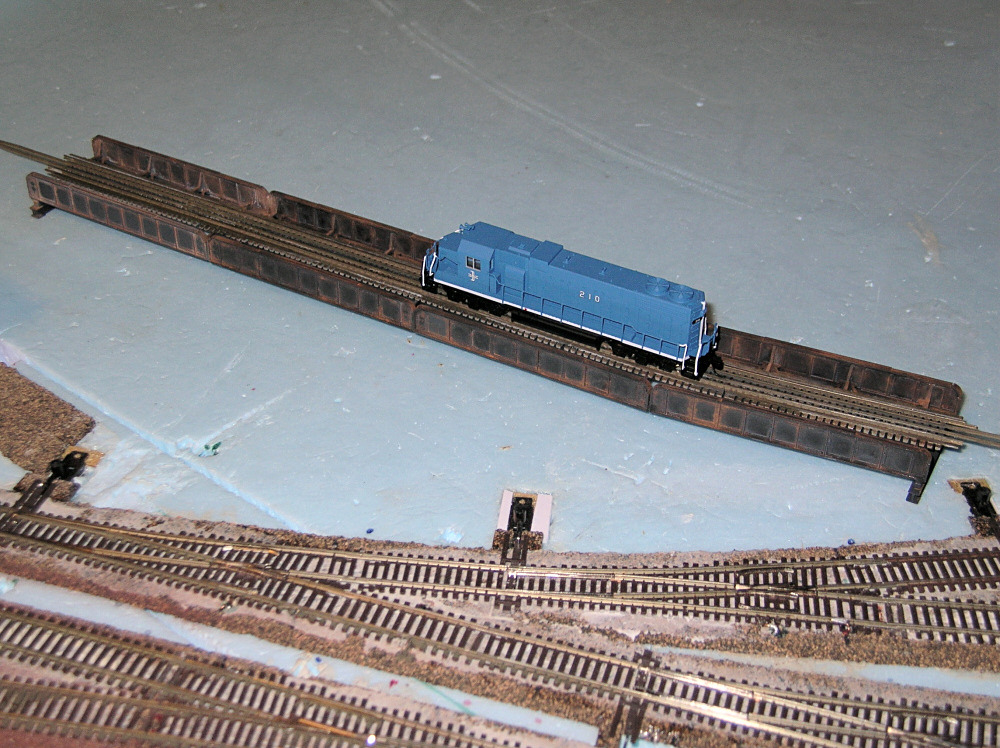

You can buy or build a bridge and add a piece of Code 55 flex track. Voila! A Code 55 bridge.
Like the one below on my layout.
- Jeff
