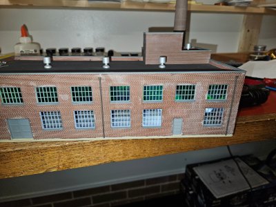

Just my 2 cents on toning down the brightness. I used Tamiya green translucent paint inside on the clear windows. A lot of old buildings used green to block out some of the sunlight. Just a thought
Thanks for visiting and the comment Jerome. I will experiment with the green from Tamiya. I’ve done the lightly sand with 1000 grit sand paper before but it looked like a scratched surface to me. I have a buddy that is backlighting his interiors with led panels. But it’s $15 per panel. I have had decent success with an LED in the ceiling and black styrene sheet cut small enough that the light just bleeds out from around the edges.
I tried to backlight it with a flashlight. The upper windows are tinted green

I normally do not let model railroady things bother me. This aisle facing curtain wall in the power plant is kicking me all over the place
Not sure why as the poster board mock up looked good, was the same dimensions and was assembled in the same build sequence I was doing the real thing
Nothing wants to fit together on the framing to the brick wing walls. The verticals and horizontal framing members needed too much trimming to squarely bond them together. Finally when I did it was a poor bond. You name it, it’s going wrong now.

I think my planning is flawed on the curtain wall. The 12 windows framed together even framed in 3 sections just has no structural integrity. I have not compensated enough to correct that. Problem is, I’m stuck for a solution
I have plans for the day out of the train room. I will talk to a buddy soon about 3d printing the wall in 1 piece but that’s a guess if it will work. This buddy though charges me for experimenting but while not my last hope it’s close.
This curtain wall will get done though. To think when I said yes I can put some styrene on the pillar I figured a few days. This thing has a life of its own.
