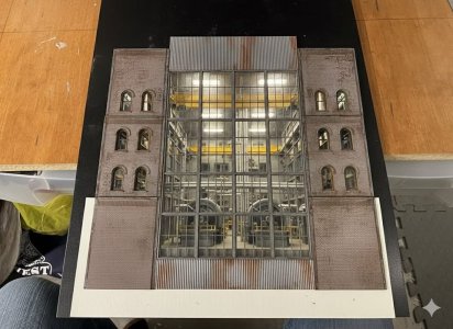

For the station interior, photos fine, but why not make it more 3d by making the walls/back/generators as cardstock cutouts? You don't need the full depth, just a little to trick the eye. Most photo places can print directly to cardstock (or do the lamination to accomplish that).
The turbine hall will be a picture about .5 “ back from the window curtain wall. The Ai you see here in the initial sketch is now a real backdrop. One of my friends took the image I gave to Ai and created a photo copy. Don’t actually know what he did but he has multiple copies for me. The lighting will be an LED in a diffuser box that will be the ceiling.
I’m not sure I could create what you described, so I’m going the easier for me route
