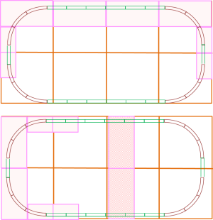

I recently moved closer to my grandson and thought we could bond with model railroading.
Im sure he'll be interested at first but also know he will lose interest with a fixed layout so i am trying something different..
Im starting with a 4x8 frame but rather than a solid sheet of plywood, i plan on cutting it into eight 2x2 squares.
I do not plan on fixed track at first so we can plan and assemble different track plans.
We will add mountains, hills and lakes to each the 2x2 modules. By using modules, we can move it to a new position in the frame when it gets in the way of a new track layout we're trying out. Scenery can also be strategically placed so it can just be flipped over to get it out of the way.
The first diagram shows the 4x8 table where pink foam has been added for elevation.
The second diagram shows the two corner modules have been repositioned for a different track plan. The cross hatched indicates where the extra two elevated modules have been flipped over.
It seems to be a good idea on paper but im looking for advice on putting it into practice.

B&L The idea of letting the grandson build his own track plan ( you too ) is great. I can't think of how many iterations I did way back when on a 9x5 gnip/gnop table. That was with brass Atlas snap track too. Then I found flex-track. Whole new can-o-worms as those needed to be attached to the base or sometimes the engine/train would just push them apart and on to the base they would go. You didn't mention a scale?

Hi. I plan to solder one rail joiner to each end of the track similar to American Flyer track to minimize frustration.

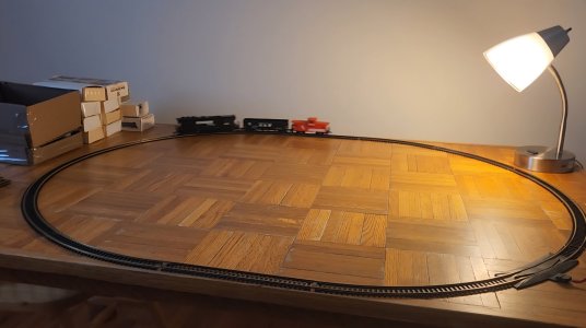

I was able to run my 30year old Bachmann HO train last week. It was doing a lot of clicking as it ran around the loop. It couldn’t go backwards and couldn’t pull any cars.
I found two cracked gears in the gearbox. After lubrication it runs much better but it will need some repair work.
I made a video for my grandson and the first thing he asked was "do you have any more track?"
I assured him i did but it shows how quickly he'd get bored with a fixed track plan so my modular train board seems to be right on target.

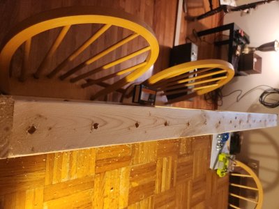

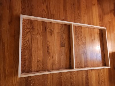

I've taken advantage of the snow day and started building the frame for the modular train board.
First i made four 2'x4' frames using 1x3s.
Then i drilled a series of 5/16" holes on each side 3" apart. This provides the ability to mix, match and add modules and legs. I chose 3" apart so i can add a 1'x4' module for a main line when my grandson is ready.
Finally, i connected the four modules using 5/16" carrage bolt, washer and nut. I made a template for drilling the holes so it went pretty quick and the holes lined up pretty well.
I plan to use a 1x4 around the outside for added strength. It wiil be flush on the bottom with the 1x3 frame to provide a 1" lip above the frame to contain the eight 2'x2' plywood modules.
Everything seems to line up pretty well but i plan to plane the top of th frame to remove any height irregularities.
Sorry, the pic showing the 1x3 withe series of holes is rotated.

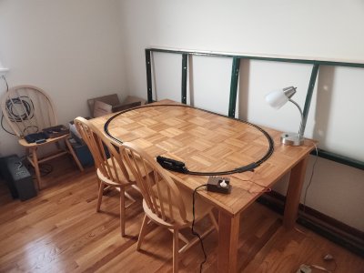

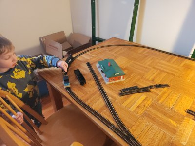

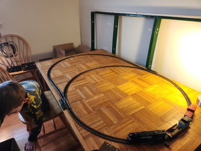

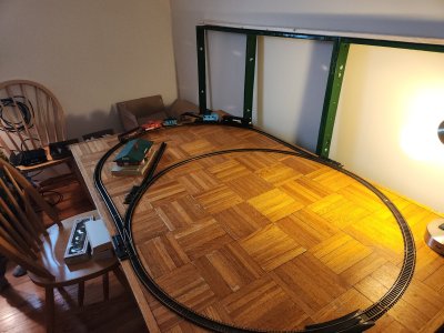

I introduced my grandson to the model railroading today.
We started with a single loop.
Then we added a turnout for a siding
Then we added a second loop
And added a siding to the second loop.
We went out for ice cream and when we got back he wanted to run the train.
So far so good.

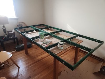

My frame is now complete and leaning against the wall behind the table. I hope to add the legs and facade around the table next.

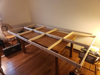

Lesson Learned #1
The wood from Home Depot is so bad that i should have stayed away from 1'x3"s and just cut 2 1/2" strips of 3/4" plywood for the frame
My results would have been straighter and more accurate.
Lesson Learned #1
That’s what I do as well, I find dimensional lumber tends to split and warp
My frame consists of four 24"x48" modules bolted together with carrage bolts. i drill holes every 3" down all the sides so you can marry any of the modules/sides together to make a...
1. 4'x8' train board,
2. make a right angle train board or
3. even a long 2'x32' train board without drilling new holes.
I do not plan on permanently attaching the track so we can change track plans every time my grandson comes over.
I plan on using eight 24"x24" plywood panels on top. This allows inclines, rivers, etc. To be moved around as required for the track plan we decide to make. They panels can even be flipped over for more options.

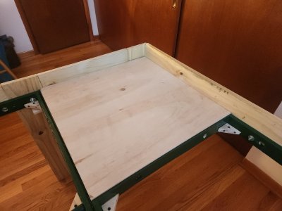

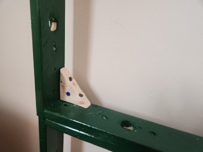

I went to Lowe's to check out plywood options. 1/4" lauen was certainly stiff enough but some of the project panels had a slight twist and would rock when set on the frame.
It looks like I'll have to add a corner brace shown in the attached picture. Its located near the bottom of the frame and 1 1/2" from the top. A 3" drywall screw will be used to go through the 1/4" plywood and into a wall anchor pushed into the center of the corner block. With a 3" screw in each corner, the plywood should lay flat.
The 1 1/2" from the corner block to the 1/4" plywood provides clearance for 1" insulation board when the panel is flipped over. I can still used 2" foam but i would have to keep it away from the corners.

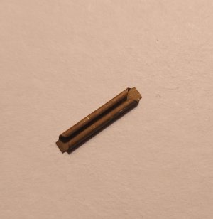

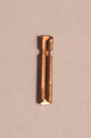

I removed all the rail joiners from my HO track to clean and solder them on.
I have 3 different types of joiners but this one is by far the best.
Does anyone recognize yhe manufacturer?
I used Google Lens and was told its a tip for a mig welder
It looks like brass, do you have brass track or nickel silver? Brass oxidizes over time whereas nickel silver oxide still conducts electricity.
I have both types of track. Some came with the bachman set and later i added atlas track and tunouts.
I have some atlas rail joiners but both ends are the same. See second pic.
The first pic has a crimp on one end making it fit real tight.

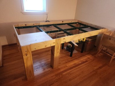

I put legs on my 4ftx8ft frame.
I went with 1"x6"s because the quality seemed better. A couple had a slight bow but none were twisted. The 1"x6" also provides a 2" wall to add elevated features and keep the train from dropping to the floor.
I picked up one 2'x2' panel to make sure it would be stiff enough and it is.
I added a middle leg at 6ft. This allows me to remove a 2'x4' module from the end for a 4'x6' table.
So far the modular design is working as planned.

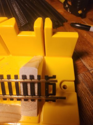

I may look funny, but i cut a 45 degree block and placed it in my mitre box and it gives me a good angle to solder the joiner to the rail.
I bought nickel silver rail joiners but decided not to solder them to the track yet. In stead, i used gorilla glue on the bottom to hold the joiner to the rail and to the black plastic ties. This worked well and the rubbery surface of the glue keeps the track from sliding apart.
I did have to remove and reposition a couple of the joiners and it was easy to use an exacto knife to clean off the gorilla glue and start over.
I can always solder the joiner to the rail at some point.
