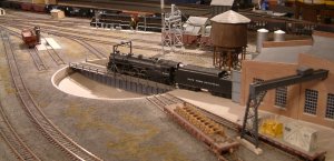

I think this works the best. Ballast everything. Then spread some white glue here and there. Press down some Woodland Scenes earth color course turf where you spread the glue. Sort of flatten it out a little. The earth color seems to look the best. This is how I did it in the scene below. If you want you can add some taller weeds. The yard I use to work in had very short weeds everywhere. The only tall weeds I can remember were around the light poles. I guess no one ever trampled them down there.

thanks for your help guys, my railroad's a branchline soo i think i'll ballast and put on some weeds. im goingto have unloading docks on one pair of tracks so i think we'll be fine with ballast and some weeds.
George, that's a great example of a relatively well maintained and weed free Class 1 yard compared to my down at the heels shortline. The northeast also seems to get more brownish weeds like that. Down here, weeds are big and green. :)
