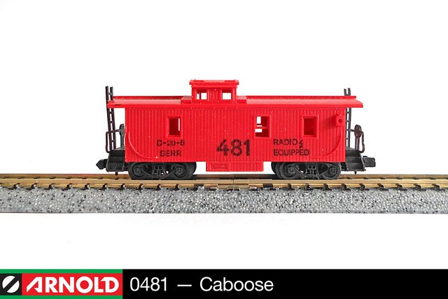

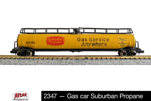

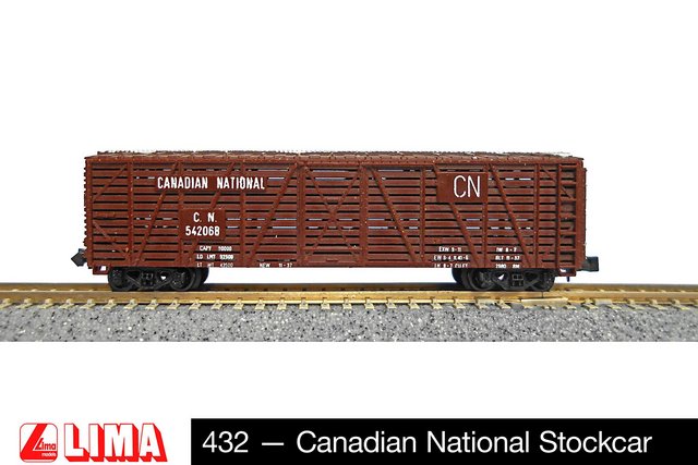

Since a year I own some N-scale trains, most of them second hand. I love cleaning and repairing them back in working order. Because of that, my rolling stock is a mixture of all kind of trains. I do not own a permanent layout (yet….). In my collection are several USA cars from Lima, Atlas N-scale and Arnold N. For this train I am looking for a American locomotive to pull them.

Some of my USA cars —>

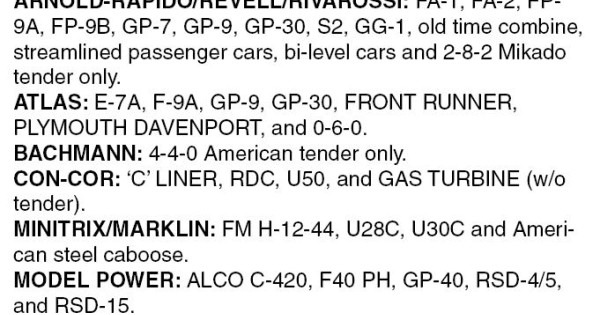

There are much better F-7 locos made in N scale than Bachmann. Minitrix comes to mind, made in Germany, and they came with Rapido couplers. I don’t know if they are still being made, since they are an old design from the 1970’s, but the factory made many, so they should still be able to be found in the used market. Also, F-units were made by Kato of Japan, and the Kato versions were likely the best running F-units on the market. Many earlier Kato’s also came with Rapido couplers, though more recent releases use Kato’s knuckle coupler, which is compatible with the Micro-Trains knuckle coupler, which are probably the most reliable N scale couplers on the market. Steer clear of the Intermountain N scale F-units because they are known to have zinc-pest infected frames, and IM refuses to service them, claiming “they are out of warranty”. Some of the Micro-Trains FT units also had some zinc-rot afflicted frames, and replacements are likely unavailable. Most MTL products are made in the USA, but for some reason, their N scale loco frames were cast for them in Asia.
Consider making up a couple of coupler adapter cars with a Rapido coupler on one end and a knuckle on the other. Atlas has made cars with both types of couplers and Micro Trains still lists their #1500 trucks with built-in Rapido couplers, so making up a pair of coupler adapter cars should be easy to do. Then you can run both types of couplers in the same train. Be careful with Micro-Trains cars however, since, once you have a couple, because they are so much better quality, you will never look at any of the other brands the same way again!
