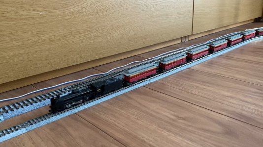

BTW, I still have those old time cars. Changed the trucks for power pick up ones from Kato, added lights and drag them around the room at least a few hours a week. Completely non-prototypical but it has lights! haha
