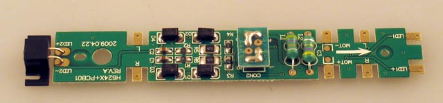

I'm getting desperate, because I'm kinda a lost sheep. I was trying to figure out an easier way to get sound onto my Bachmann GP7 EMD 567. I have done some research so and here's more questions?
I noticed that the GP7, factory circuit board you can install an 8-Pin Plugin. Just like the picture below, but it has a very small green rectangular chip.
Now my question is would it be possible to hook up this:
to This:
and then into (CON2) here:

Maybe.
If you can fit the physical decoder (it's actually bigger than it looks) into the locomotive, then it will work. The speaker can go in the fuel tank (Bachmann put a speaker enclosure in there).

I just did the exact same setup, albeit to my Spectrum Steamer 2-6-6-2.
However, The setup is the same. Just like you mentioned and in the order you said. Just make sure to only trim the purple shrink wrap on your decoder on the end. If you trim it all off, it voids the warranty on the decoder. (Assuming it is a soundtraxx.)
I had plenty of room since I have the tender to work with, but I have seen these be a tight fit in Diesels. This was my first decoder install and I found the process to be really easy.
