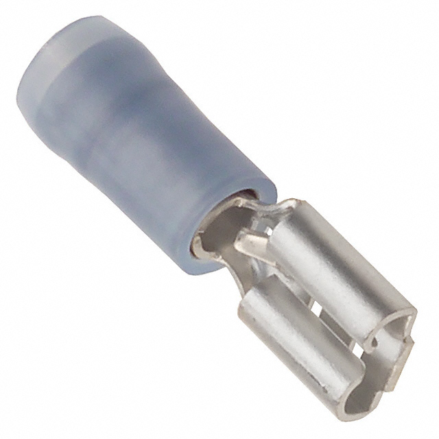

on one of my units I used electrical spade tongue disconnects that would slip onto the metal loops that came up and over from the trucks. That way its easy to remove the trucks later on for whatever reason. I then soldered wires from one of those, to the top of the motor, and back to the other truck (cnnector). Something like this:
I also removed the plastic and bent the end of it straight up to clear the inside of the shell.
