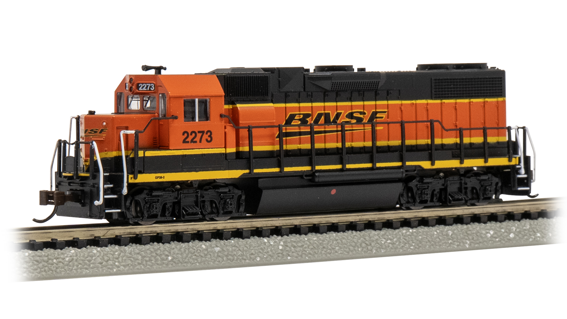

And the EZ Mate couplers on that GP38 are oversized anyway. Kadee does make semi-scale couplers, if you want to go to the trouble of switching over, though you'll probably find your stuff comes uncoupled during operation.

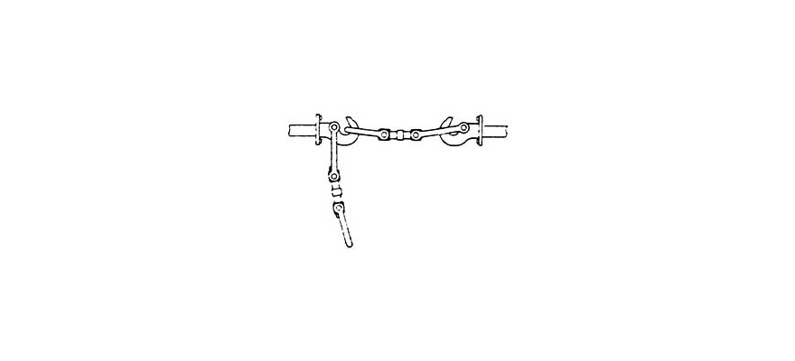

And forget about a scale coupler. If they used scale couplers on locomotives and rolling stock you would be forever coupling and uncoupling wagons. I believe Weinert makes a true-scale coupler for display pieces and trains that will never be uncoupled, but they are quite fiddly and require a certain amount of patience to couple up.
Right in the middle of the two horizontal rods is a nut that tightens the connections after the wagons are buffer-to-buffer.
