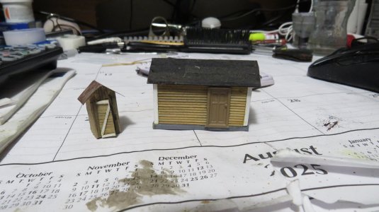

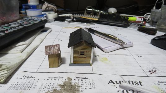

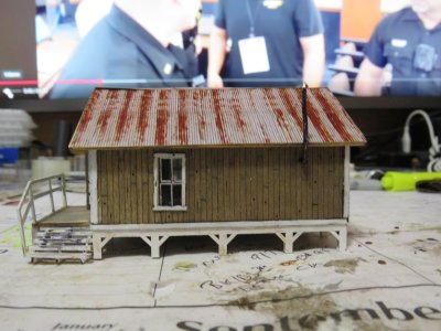

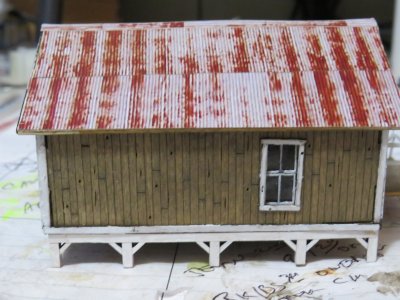

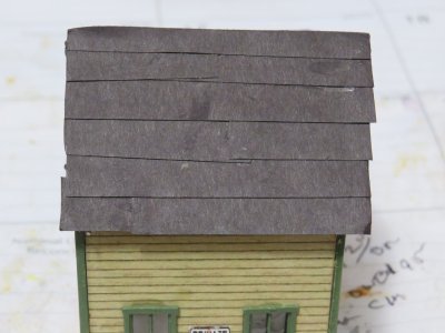

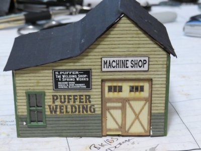

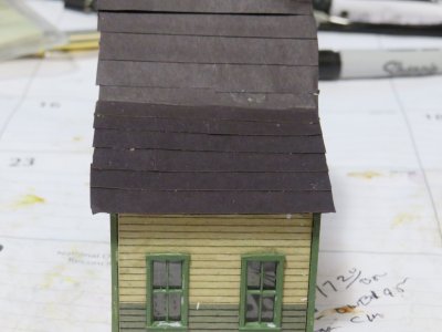

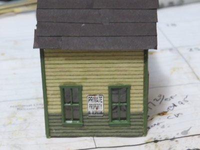

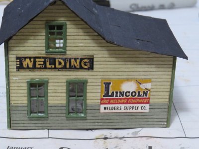

I didn't realize that it's been awhile ,so I wanted to update my progress. I had a piece of 3/8" Lexan laying around from a previous project . I've been using that that as the base for my cutting. So far so good. The only downfall is that it leaves light surface cuts on it. I plan to take a da sander with some 220 grit sandpaper to it to get the cuts out to keep it flat and smooth. I've built 3 or 4 kits since the last post. think I'm starting to get back into it but I need some more practice and PATIENCE!! That said here are some of the kits I've done . Just a side note ,these aren't really done yet as I need to add the detail parts to them when I place them on the layout. And again I really appreciate all of your replys and help. It has made getting started over again a lot easier.
The first 5 photos are pat of the trackside details kit. The next 5 are the Puffers Welding kit. This one is the first kit that was laser cut that I have assembled I really like that aspect of it. I will post some more in the next post

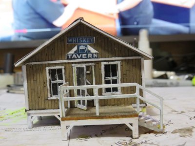

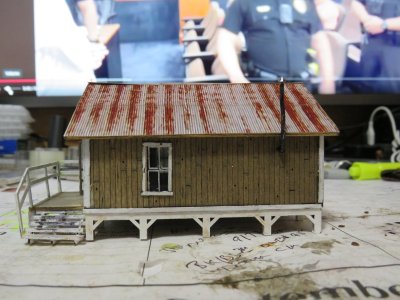

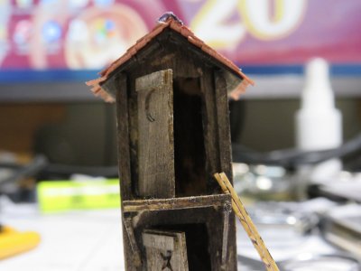

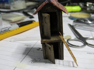

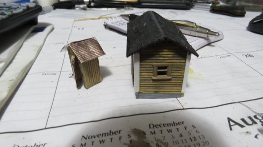

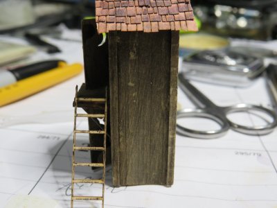

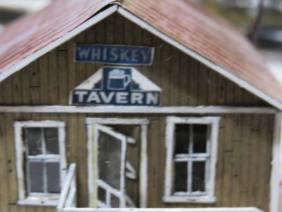

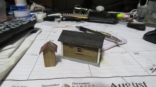

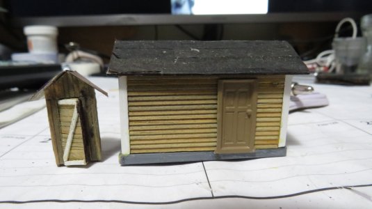

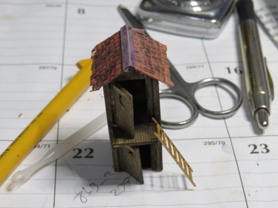

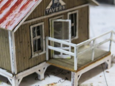

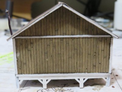

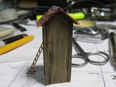

Here are some more of what I've been doing. The Tavern kit is also a laser cut kit. The double stack outhouse was a kit I saw on E-Bay and I just loved it .I think it's hilarious. If yo look closely you can see the word Boss on the bottom door. The top door says Employee. That photo may be in the next post due to limits on photos allowed.

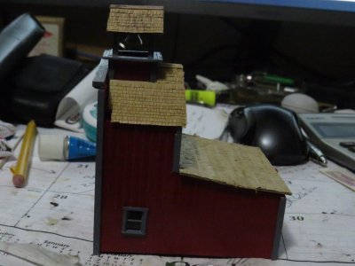

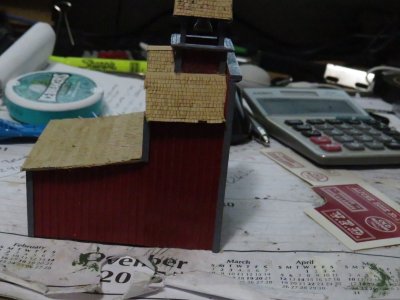

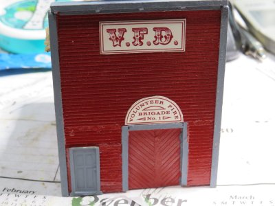

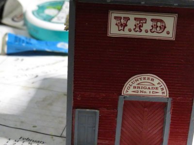

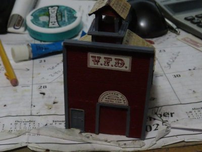

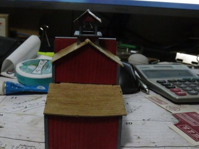

And here's some more. And here's the fire house. I'm trying to find some early 1900's fire equipment but it is proving difficult. I have found a few firetrucks ,1920's era but the selection is very thin from what I've found. As usual any and all comments are welcome.
