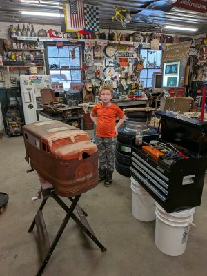

A month ago on a "Parts Safari" looking for items for
one of my Hot Rod Projects,
I found this Child's ridable Train Engine.
Had my 8 year old Grandson come up, and a Trip to the Junk Yard so he could make the Final Inspection and Price Negotiations (of course it's "Grandpa's Money")
SO we are NOW the Proud Owners of a ALCO FA diesel engine, which we have No Clue who built it, or any idea of what we are going to run it on !! But the "Build" is going to be the fun part.
Here is what we bought.
Hopefully I can get pictures to come through.
We are looking for ANY information on who made these engines ?
What was the Original Powering System ?
And Are Any Parts Suppliers available ?

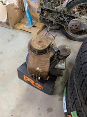

This poor thing has been Butchered with a Torch to put a Briggs Lawnmower engine in it. It is a Very Crude Belt drive by moving the entire engine back and forth.
So my Grandson is Having a HOOT with it's first "Look See" in my Shop.
Found out why we thought the engine was "Stuck"....
Surprise !!
A Mouse House !!
Again,
Any Leads to help us with Rebuilding it RIGHT, and
Maybe a Full Restoration.
Grandpa and my future Wrench Stealer....

These were made only for a few years by Doepke Model Toys Company around 1955-1960.
They came issued in a Battery Operated unit, and a Gasoline Engine unit.
The Gasoline Engine unit used a 1.75 HP Clinton Engine. And found some general pictures of a unit with the original gas engine set up. Now we have GOOD references to go from.

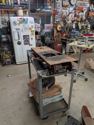

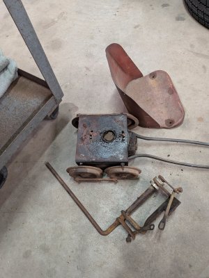

My Grandson was up for the Thanksgiving Day holiday weekend.
We have more of it disassembled.
Oh, that is Ryker's tool box on the 5 gallon pails.
My Dad left ALL his tools to Ryker in his Will, including power tools......
So, he Wants to use "My Own Tools" when working on this project.
