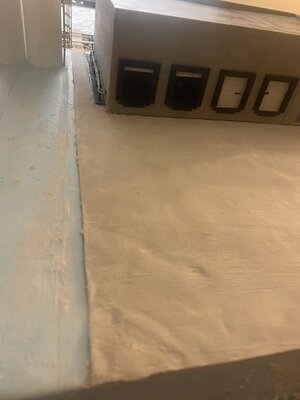

At least 2 more weeks before I go back to work but feeling better so I went to the "train store" and picked up a "WS Learning Kit" for roads It was enough to get this scene started. It's my first attempt at pavement. After the first day I think I can make it turn out pretty well. Tomorrow I'll sand, tweak, clean and hopefully paint.
Again, my first attempt at pavement so any advise is welcome! Thanks for reading

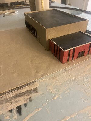

Wanted to get this painted today but the "Asphalt Top Coat" paint that came with the kit is junk. Completely hard. Who knows how long it was sitting on the shelf.
Looks like black paint to me, maybe a touch of grey mixed in? I have those colors and plenty of others in acrylic paints. Before I mixed something up I thought I'd ask for suggestions. How do you all paint an asphalt parking lot?
Thanks
Paul
It all depends on the size. Larger ones get a coat of paint from a rattle can of Krylon Black Primer, followed by a very light spraying of Krylon Gray Primer. Smaller areas get a brush coat of Polly Scale Grimy Black. This is when I paint directly on the plywood benchwork. Other close to the aisle ones are made with pieces of tarpaper glued to the plywood. It fades rapidly under the lights before stabilizing to a light gray.
Thanks, Willie. I got board and just went for it before I saw your post. Ended up using a mix of more gray than black. I'll upload pics of this scene as it develops...

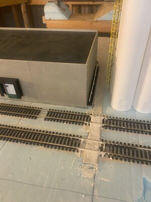

Some tracks there are ready for ballast. I think I'd like to paint the ties and rails with WS paint markers first. WS video shows painting inside and outside of rails. Locos pick up electricity from the top of the rails and where the wheels contact the inside rail I believe. Will painting the inside rail reduce conductivity? Will not painting the inside rail look terrible?
Any thoughts?

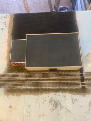

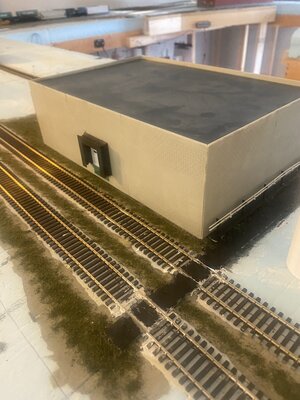

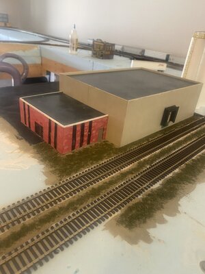

Here's the scene so far. As a beginner I usually try to learn some techniques before I start but there's no substitute for experience. I don't expect to get a call from MR mag. asking to feature my layout in an upcoming issue but it is fun to make the blue foam go away and bring the layout to life!
I'd like to paint the track and ballast tomorrow but not sure how to proceed (see post #78)

Looks good so far, might want to hold off on the ballasting till you've laid a bit more track, and your totally happy. Have you run a train on it yet?
