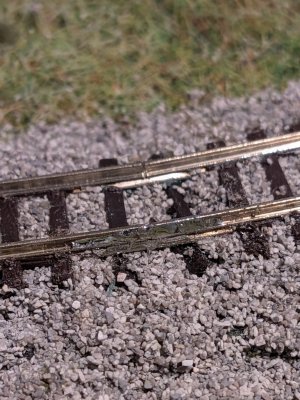

[sigh] Well, I relaid the track, soldered the join, and ballasted to keep it from moving (I still have some touchup to do); then removed the pins. Pic below (try not to wince at my soldering...).
Anyway my Broadway Limited diva still derails there. It's the weirdest thing. If I run it over at a crawl I can see each driving wheel on the outside rail lifting off in turn very slightly (I will try to get a pic), which at any reasonable speed is enough to derail the leading truck. It looks like what I would imagine would happen if the flange were hitting some obstruction on the inside of the rail, but there is nothing there.

Jacob: It does not look like either rail is in it's joiner. That what you wanted?
As to the soldering - no worry you will get better ... practice, practice practice.
Dang, I intended to mention that. It's a peculiarity of Peco 55 track that it looks that way. The code 55 track is the same height as their code 80 track, so that they can be mixed, but the track is "buried" into the sleeper to create the lower profile. There is a "fake" foot to the rail on top of the sleepers just for appearance, and then the "real" foot that joiners go on to is below that. Every time I post a picture of it, people who have not seen Peco 55 track up close think it looks like the rail is not in the joiners.
Mind you, on one occasion it actually wasn't in on one side although I thought it was, but I figured it out by the misalignment of the rail heads.
Also, yes about the soldering. You should see how bad it was when I first started!

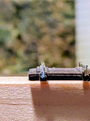

ETA: here is a much-magnified pic of Peco 55 end-on, which I hope shows the two feet, the upper one at sleeper level and the lower one buried in the sleeper. Sorry, this is the best pic I could get with 8x magnification and a tremor!
