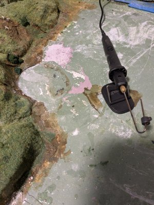

My pond is finished. I think it's OK, not great. Here's a series of pictures showing my progress.
  1. Before. I decided to cut out the pond from the foam board. (I tried originally doing the thing most videos describe, i.e. put down a bead of glue then pour the Realistic Water inside. I did not like it at all.) My foam cutter has a u-shaped insert, which seemed ideal. When I practiced on a scrap piece of foam, I could not get a consistent depth, but then I struck on the idea of attaching a depth stop (normally used for drill bits) and it was a lot better.
  2. After cutting out the hole. I forgot to take the picture before I started painting. It's about 4 inches across, or a scale 50ft or so.
  3. Painted. Aqua blue in the middle, Earth Undercoat around the edges. I tried to blend the two colors where they meet so as not to have a harsh transition.
  4. A few layers of Realistic water go in.
  5. Finished. For the last couple of layers I added a few drops of Earth Undercoat to the Realistic Water because I wanted it to appear murky rather than crystal clear.
