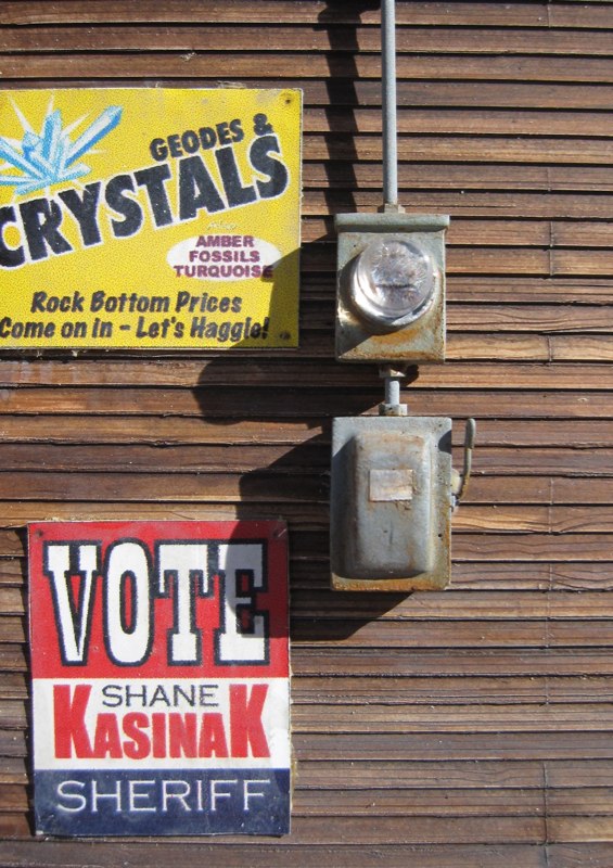

1/24th scale electric meter and circuit box
I just finished making an electric meter and circuit box for the rock shop in Dos Manos. The boxes were made of styrene, then I made a silicone mold and cast duplicates out of resin. The "glass" dome was turned from a 1/4" diameter acrylic rod, using a hand-held drill as a crude lathe. Underneath the dome is a vinyl sticker I printed out, with a photo of an electric meter on it.
Holy C-Rap Ray, simply awesome work!
I'll be doing up a small station this spring, you're raising that bar with every post! :D
More amazing work, Ray. That sun is unmerciful in showing flaws and your work still looks real.
Ray, you need to work a little harder at the realism. I suggest you build a nano motor, and install it inside the acrylic lens. We should be able to see the little wheel spinning around inside to indicate that electricity is being consumed. :rolleyes:
I remember that set of buildings, Ray. There's always one more detail to add, though, isn't there? :)
Yep, in fact I'm working on a mailbox for it right now. Still have to make some more signs too, for the front of the building. And eventually I should add a shopkeeper and maybe a customer or two.
