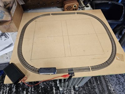

Yes, that's just Atlas Code 100 flex track. About 20 years ago I made a set of radius tools out of poster board with a compass and...

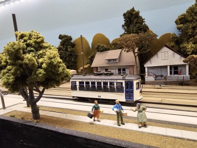

24" is plenty wide for single-truck or even double-truck trolleys. This is a 24"x36" piece of MDF with a few pieces of Atlas flextrack...
